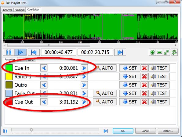

I am suggesting a feature to place hooks in a playlist with pre-defined Cue In and Cue Out points set by the Track Tool. The availability to place a Hook into the playlist. Maybe adding another button in the playlist.
For example how it could be used:
"Within the next hour you will listen to the brand new song from Rihanna (SHORT HOOK HERE) Disturbia, that's the name of that creation. Also you will listen to Shakiras track Spotlight (ANOTHER HOOK HERE). That's the sound you love. Stay tuned."
On that attached screenshot you'll see how it's implemented in the software "mAirlist" since years.
Can I hope this feature will be added in RB?

RadioBOSS has Cue In/Cue Out feature, so you can make a copy of tracks and create short versions of them (those points are called Start and End in RadioBOSS): http://manual.djsoft.net/radioboss/en/track_tool.htm
We also have plans to add Hook In/Hook out points, but that's for the future, I think, RadioBOSS 5.7.

Noted, thanks! There's a good chance that the "hook" feature will be added in RadioBOSS 5.6.
The feature added in RadioBOSS 5.6: https://www.djsoft.net/smf/index.php/topic,4846.0.html
