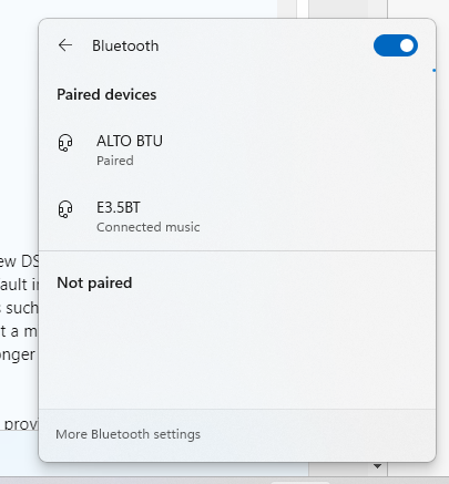

1) Yes but its only affecting RB and states device is connected with same name as it was before. but still RB creates this error shown in image in regard to main sound card
2) In regard to Auto Intro. I have now had a look at it and it seems unusable to use a microphone with your new DSP features. Firstly, to allow RB to create this output of #cart Wall and #jingle not currently Auto Intro, as an input this ties up the only default input on Windows that could have been used for a microphone to send the signals from #Jingles and #cartwall into the microphone DSP. As such this seems flawed as you can no longer use the microphone. We have the tried to purchase a Alto Professional Bluetooth Ultimate to put a microphone on Bluetooth but it is not clear if this will be available on an input as the default input is set to the Virtual Soundcard and is no longer on a port as such that Sound Tool or RB can use!
A way forward would be to set this mic device or port to this same port and bypass its existing port unless you provide main sound card. Currently this is not possible with the only default input on windows being used being used!
Also as you can see when this Alto Professional is on it appears as a headphones that need to be channelled as an input I am not sure this is possible as there seem no input to place it on !
RadioBOSS searches devices by IDs, as Windows assigns them. Using device name is not reliable because it's quite often when there are several devices with the same name.
Default device is set in Window. When you select "Default" option in RadioBOSS it uses Windows's default device.
