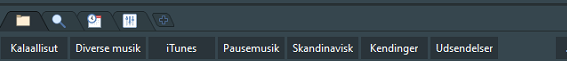

I have version 7.0.7.0 where I have been able to make those folders. see picture.
but in a other pc with version 7.0.8.0 I can't remember how to make those folders, I can't find the way to do it, can you please help me

Ok, I found out using the additional workzones I can make the folders. But every time I e.g touch the cartwall the additional workzone with all those folders disappear and I then have to open it again. Whenever I touch somewhere in RadioBoss it's disappear and I have to open it again. In version 7.0.7.0 it's always stays where it is even when I touch the Cartwall. How is it possible to lock it so it's not disappear?
I managed to get the folders locked at the right down corner. See picture 1. It’s ok with that even that I always used to have the folders to the left. If I use additional zones the folders are not locked because I cant figured out how to lock it, see picture 2. So whenever I touch anywhere in RadioBoss the folders disappear down to the procesline. And I have to open it again.
On version 7.0.7.0 I somehow managed to lock it to the left. See picture 3.

On the picture 3 it looks like you have enabled the "Additional zone" where the file list is added. Additional zone is a separate window, it's not integrated into RadioBOSS's main window. You should enable third work zone (menu View -> Work zones -> 3), this will activate the bottom left zone as on picture 1.
