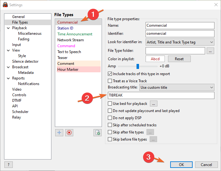

Hello, is it possible to send specific metadata text while commercials are playing and have it disappear when they end? How can this be achieved? Thank you!
You can do it from File Types. There are options to use a custom title for the different file types that are sent to the nowplaying file
Great! I am using the demo version to check the options.
So, are the settings below correct for sending TIBREAK for every spot played from Commercial file type? Thanks.
PS.: Is this option available on RadioBoss Cloud as well?
