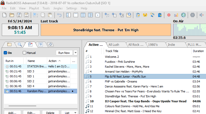

Stopping these can be tricky, but I have managed to get mine to stop. However, there's still an issue with the 2-hour framework on the schedulers. It seems to set a random playtime, sometimes amounting to 1.5 hours, despite the playlist schedule being set to repeat every 2 hours (120 minutes). This inconsistency is strange because the edit schedule shows a repeat every 2 hours. If RB is started, it shows 1 hour and 20 minutes until it reaches 1 hour and 20 minutes, and then it runs every 2 hours thereafter.
As you can see the time is 9:00am and the schedular has played 15 songs and has an hour left on Scheuler but 1 hr. 32 left to play so it will be cut off by scheduler event
What it seems to be doing is setting the schedule on the hour not at the start time of the schedule so that it finishes on the hour I presume this is what its supposed to be doing?
