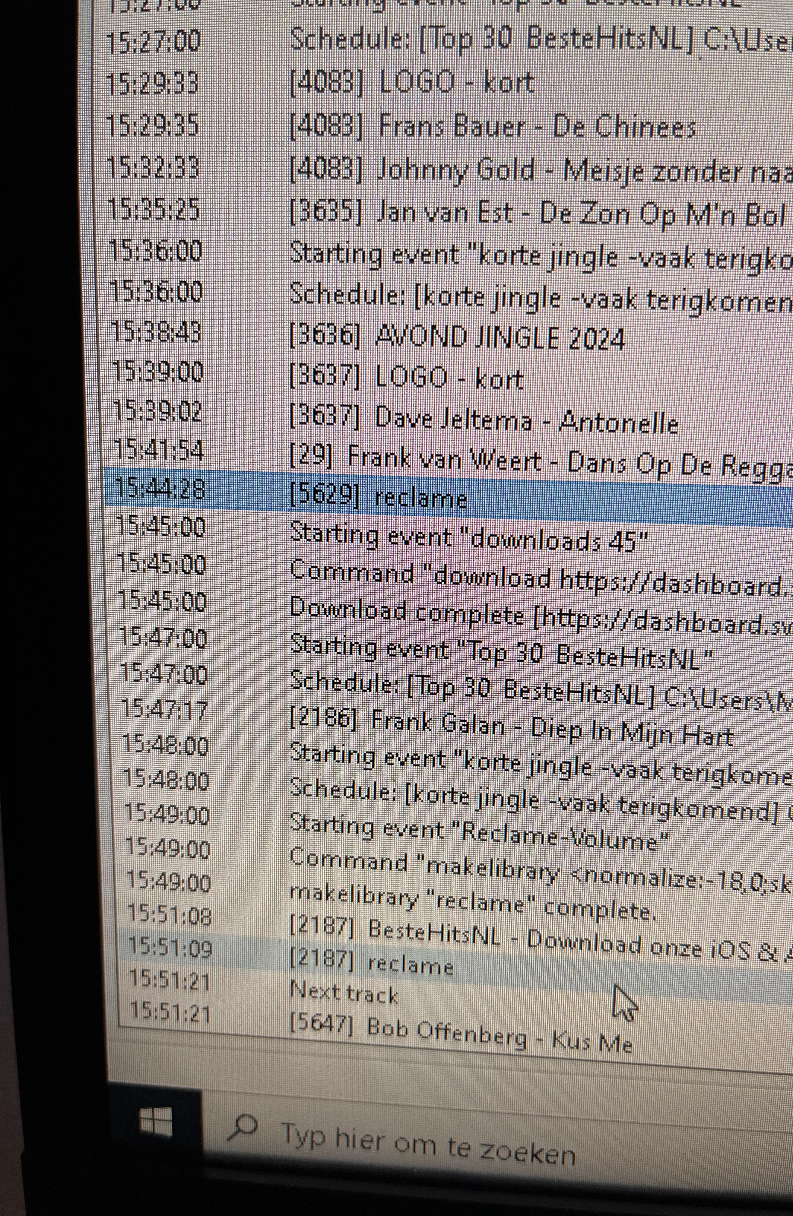

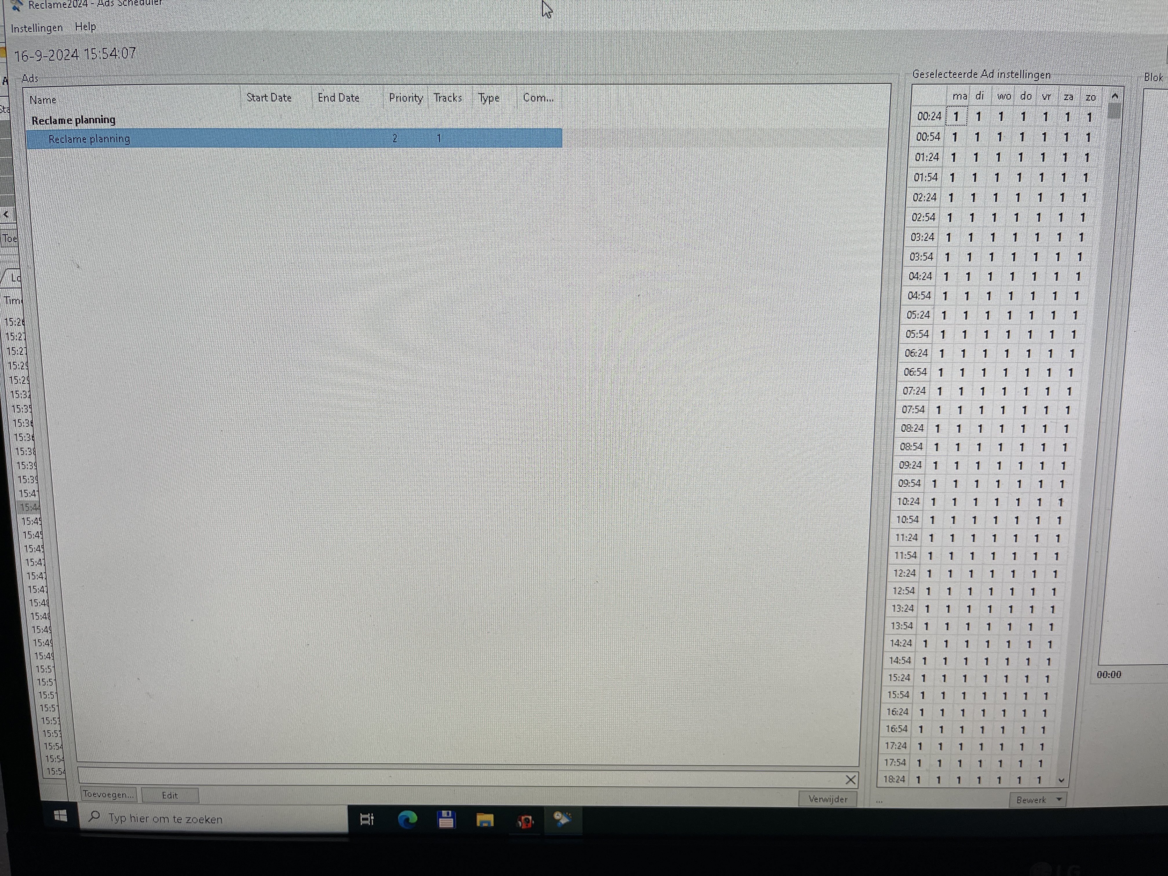

Kevin H Member Monday at 2:11 PM #1 Scheduler problem Since a few updates he has hit the commercial 3 times. It should be 1 time. I set the time to ..:54 and commercials to ..::24
Kevin H Member Monday at 2:55 PM #3 The commercial is played twice. It is on 54 1 times Attachments IMG_7169.jpeg 6.5 MB · Views: 7 image.jpg 6.1 MB · Views: 8
D djsoft Well-known member Staff member Tuesday at 7:32 AM #4 Kevin H said: Since a few updates he has hit the commercial 3 times. It should be 1 time. Click to expand... The log doesn't show the ads event starting. Looks like your commercial started for some other reason, e.g. it was present in the playlist already.
Kevin H Member Tuesday at 8:05 AM #5 I thought so too. I removed them from the playlist. things seem to be going well now. Thank you
