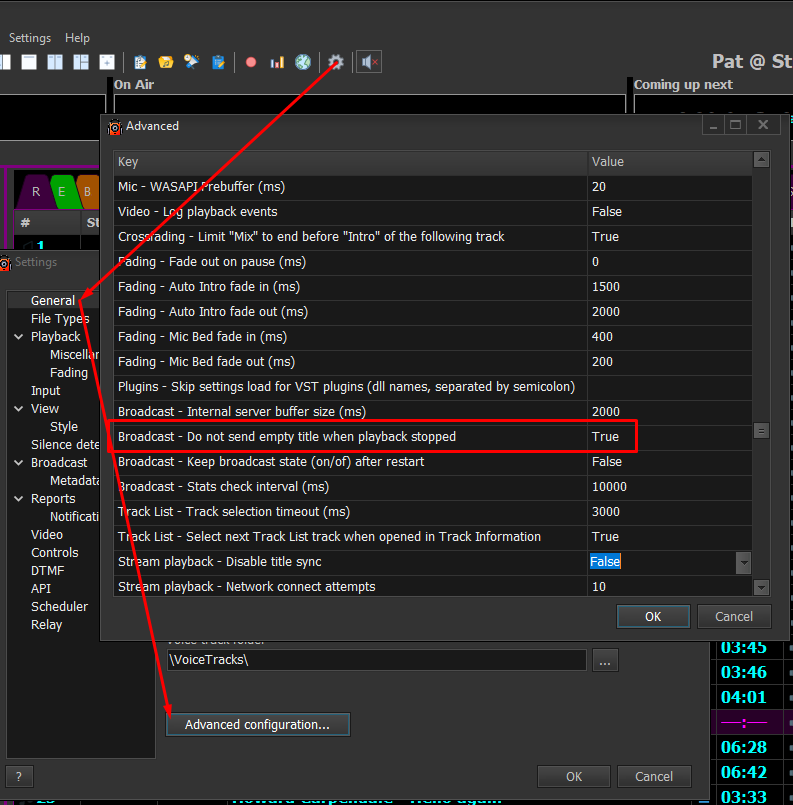

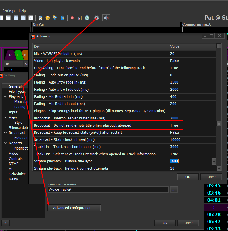

When the RadioBoss playlist stops, the stream disconnects. It reconnects when starting audio agian. But the disconnects also boots the listeners from the server. Any way to prevent this disconnecting ?
Of course, but that does not answer the question.
it seems in the case of a silence, this could also be for example there is a network-issue or otherwise,
the stream connection disconnects. can this be disabled ?
I own the stream server. It's a regular Shoutcast DNAS.
With other non-RadioBoss stations, if for any reason there is a silence, the stream to the server does not disconnect.
For example, I stream Air Traffic Control using BUTT to Shoutcast. 90% of the time, it's dead-silent as there is no spoken audio on air. The stream does not disconnect the listeners when there is a silence. This is not a setting on the server.
I only have the issue with RadioBoss. Whenever there is a silence in the audio, it disconnects the server. Very annoying.
I hope you understand.
When nothing is playing, not even the silence, the server (not RadioBOSS) will disconnect the stream - most servers are configured this way. In case of any other failure, RadioBOSS will reconnect (unless you disabled this in the encoder configuration).
Silence vs no audio at all is a different thing for the server. You can make RadioBOSS send silence as I described above. This will prevent the server from disconnecting.
