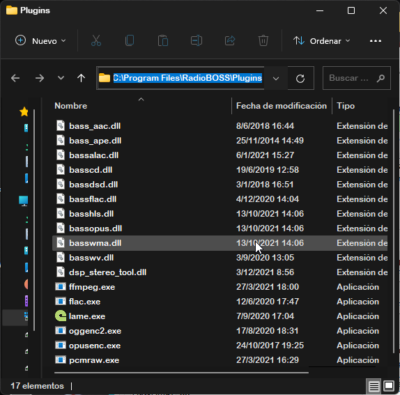

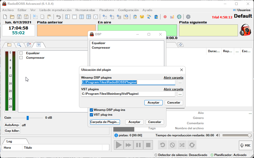

DSP plugins are not shown in the list to be installed.
I am using RadioBOSS 6.1.0.4 release candidate x64 bits, same problem I had with beta version x64 bits.
Version 6.1.0.3 beta x64 worked fine and I was able to view and install the DSP plugins.
System: Windows 11 Pro 21H2 build 22000.348 x64 bits

6.1.0.4 release candidate x64 bits & beta version x64 bits DSP plugins are not shown in the list to be installed.
Nothing was changed in 6.1.0.4 release regarding DSP/VST compared to .2 and .3 beta versions. Please ensure the plugin architecture matches the RadioBOSS architecture: https://www.djsoft.net/community/threads/using-vst-plugins-with-radioboss.4393/

Hi Dmitry,
It's weird, as I said you don't see any plugin, not even the ones that RadioBOSS brings by default in the x64 version. Stereo Tool DSP plugin was downloaded from the official website which provides an .exe that then installs a .dll. With the previous versions I had no problem seeing and installing it.
Anyone else using Windows 11 Pro 21H2 build 22000.348 x64 bits who can shed light on this issue?
