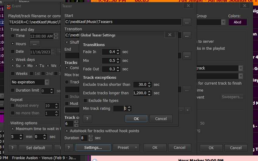

Demitry, Came across a fault when working with Teasers.
It seems under settings ->Track Exceptions that when I change exclude tracks shorter i change to 110 secs. However, It changes back to 30 secs as soon as I click out of the box or it I just click Ok. Enter back into settings to check and it's on 30 seconds.
Is there any way you can reset the cap to 120 secs. That way when you have 6 songs you want to tease, and you tell the system to look ahead 12 items, and you have this capped at 30 secs, you are going to include liners, jingles, and sweepers above 30 seconds to be added to teaser. Setting the cap to 120 secs will eliminate this and only pass the songs you're looking to tease.

Yes, this will be done in the next minor update.
