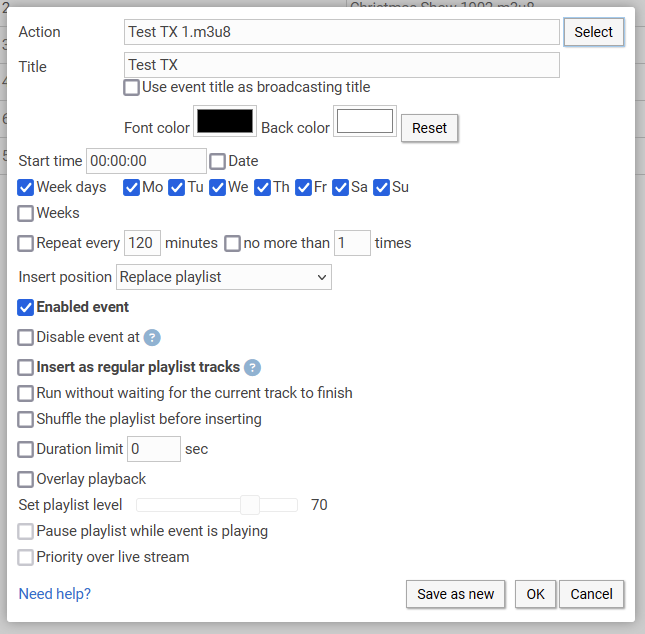

I'm having some problems getting the scheduler to work as I need it to. The use case is as follows
I currently have one rotation which the scheduler fires once per day at midnight. Then, each day there is a pre-recorded programme, assembled into a playlist which goes out at a designated time. After the playlist ends, the rotation needs to pick up again.
What I did
I scheduled the rotation as a daily event at midnight:
For the pre-recorded programme, I set the scheduler to play it during its intended slot.
What happened
The rotation ran as planned and continued to loop from midnight until the time that the pre-record playlist was scheduled.
The pre-record playlist was broadcast as planned
And then when it ended, it looped - incorrectly
To get the rotation working again, I had to manually click 'run' against the item in the scheduler
Previously, I experimented with the playlist of the pre-recorded show, by clicking Insert as regular playlist tracks but that resulted in the rotation then having this pre-recorded show inserted into it which would play arbitrarily.
The docs are a bit light when it comes to the scheduler so I'm a bit stymied as to what's wrong.
If anyone has any pointers, I'd be grateful!
