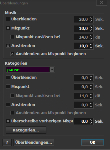

Si esta es mi configuración actual y el programa no reacciona, hace exactamente lo mismo: corta las canciones. Disculpen mi ignorancia.

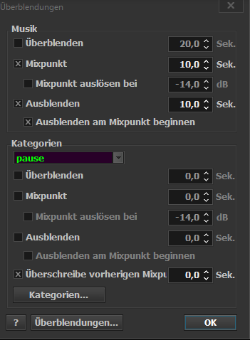

Mira la siguiente canción y la misma configuración.

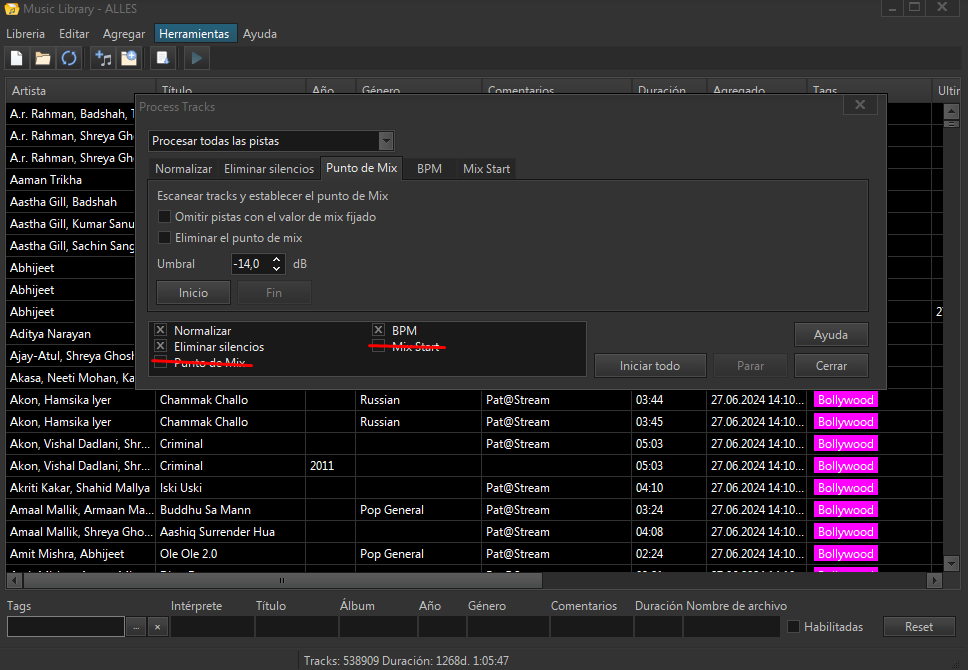

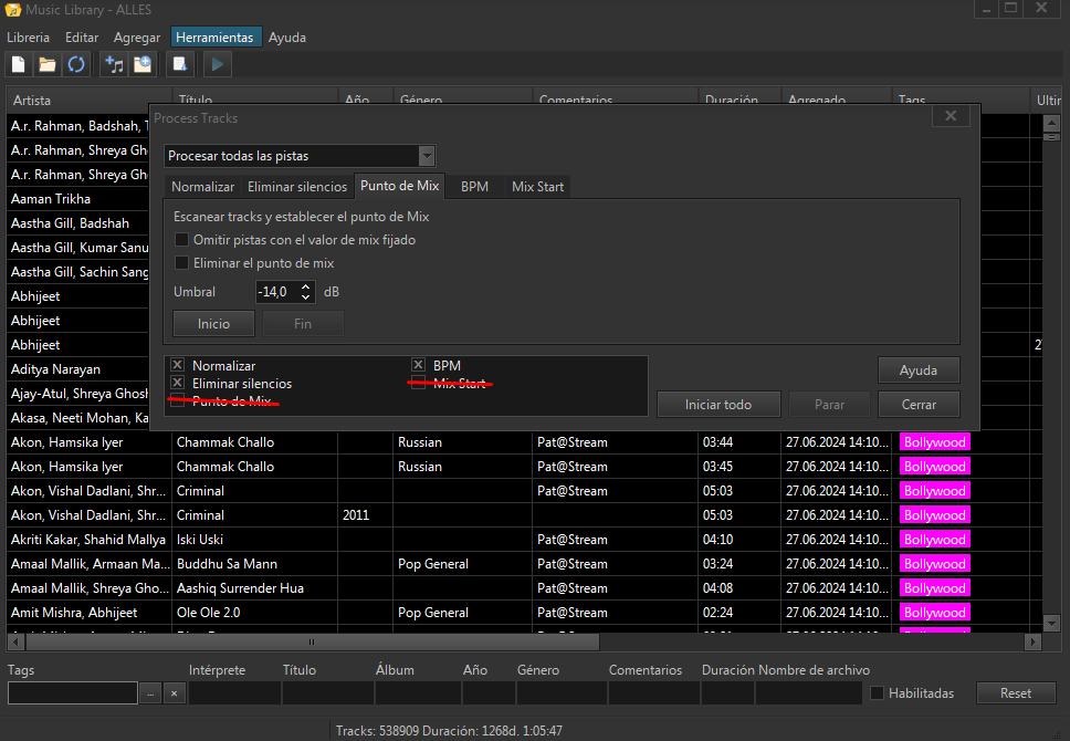

I will no longer answer questions you ask in Spanish
Please write in english
have you edited your music in the library?
if yes then check if you have the x in punto de mix and mix start if yes then remove it or remove the data with remover puntos mix start and eleminar el punto de mix

Mr. patrick.de-bruyn, thank you very much for your help. I'm using Google Translate to respond to you, because unfortunately I don't speak English.
Apparently, Radioboss recognizes my music folders and has marked them at the points where this red line appears. I've used other music folders unknown to the software, and everything is fine, and it recognizes the correct silences and crossfades.
Is there any way to reset Radioboss to remove this recognition of songs?
Thank you for your help.
What I would do in your case
Drag and drop the folders that are not correct into a new music library, preferably into a new library
then click on tools then process music tracks
in the window below only the x in mix point and remove mix point, for mix start also remove mix start point
This should restore the files to their original state
This cut line appears even with the Crossfade options disabled.
The Crossfade window is general crossfade options. Tracks can still have crossfades added if you used Segue Editor, or added crossfade options in Track Tool or used the Process Tracks option in the Music Library that set the Mix points (the red line you see is the Mix point).
