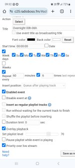

Hello, if I want to interrupt a live stream that is running and play a music playlist between 00h-06h (please check screenshot):
1- I need to keep the option Set playlist level to "zero" (here "playlist" level means the "live stream") or pause playlist while event is playing? Please, consider that pause "playlist" means that playlist is the live stream
2- I need to set "priority over live stream", right?
3-Also, because the event is schedule to start at 00h and finish at 06h, if the system show me the "last repeat time" is at 05h this really means will be started for the last time at 05h and will finish at 06h?
PS.: From 06h until 23h59 the station is operationally with live source.
I really appreciate your help, thanks.
You should set its level to zero, but leave it playing (do not pause). This way, when the overlay event ends, live stream will resume playing immediately.
If you added your live stream to the playlist and play it from there, this option doesn't do anything. This is only when you stream live: https://www.radioboss.fm/support/radioboss-cloud/live-broadcast/
Finish time is not configured in the scheduler - if you need to start event at some time and play it for a fixed time, use the Duration Limit option.
