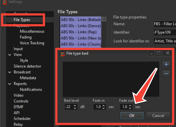

I have downloaded the update and I'm still getting the same problem. No music bed fade out. I wonder if the issue might be arising from the fact that there are two ways of deploying music beds - first, within the universal voice track setting itself (now moved to Settings -> Playback -> Voice tracking) where you have the option of loading music beds, and second, within the File Types section in Settings, where for each file type I can select specific unique beds. I do the latter for all my music bed deployments across all my programming, and I'm finding that the music bed fade out settings don't work at all there. You will notice that the second use case allows one to set bed volume levels for each file type, and so far I've noticed this is not affected by whatever the universal voice track bed volume level is, and for that matter the fade in and fade out settings too. Maybe music bed fade settings only work in the former use case scenario under universal voice track settings, and not for file type music beds. The attenuation settings are working in both instances though.
But there are no fade out settings for bed at all, it's supposed to fade out together with the track itself. As opposed to a voice track, for which bed can be activated/deactivated mid-playback, bed for file types is supposed to play from start to end.

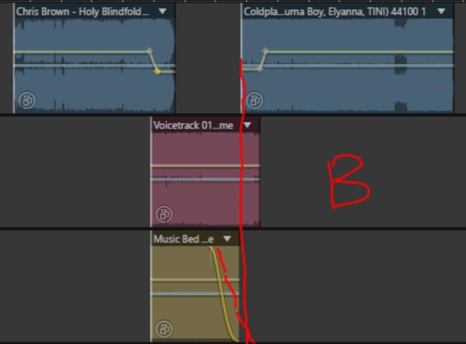

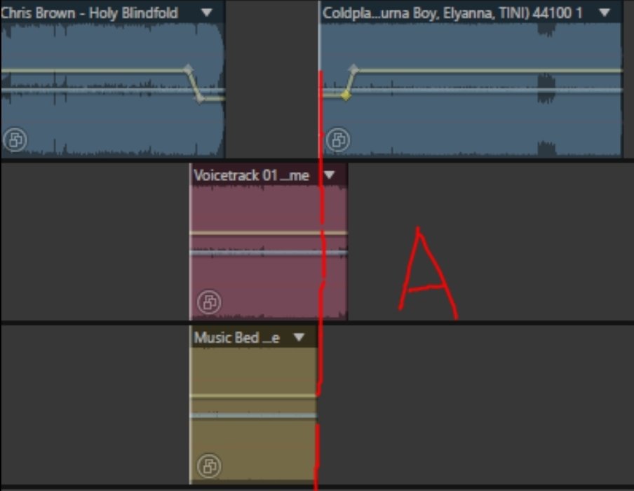

This is the typical scenario - voice track plays as the song fades out (triggered by the song's outro marker) , and an accompanying music bed begins playing in the background after the song has faded out. The voice track continues, and suddenly the music bed cut outs abruptly, and the proceeding song starts playing (volume down to accommodate the voice track). The sudden music bed cutout is jarring and disorientating - not very pleasing to the ear. The issue is how the music bed cuts out when the proceeding song is triggered. It just ends abruptly.
In a typical traditional live radio scenario, the DJ is controlling the levels on his mixing console, and if he's talking over a music bed, he fades the music bed out while increasing the volume of the next track. Radioboss currently does not allow us to reproduce this kind of natural smooth transition. I want to be able to fade out the music bed before the next song starts playing, or perhaps crossfade it into the next track. Anything but an abrupt cut out, as is seemingly the case at the moment with music beds.
Apologies for the crude mock representation I designed in the attached images. I am saying B would be preferable to A.
