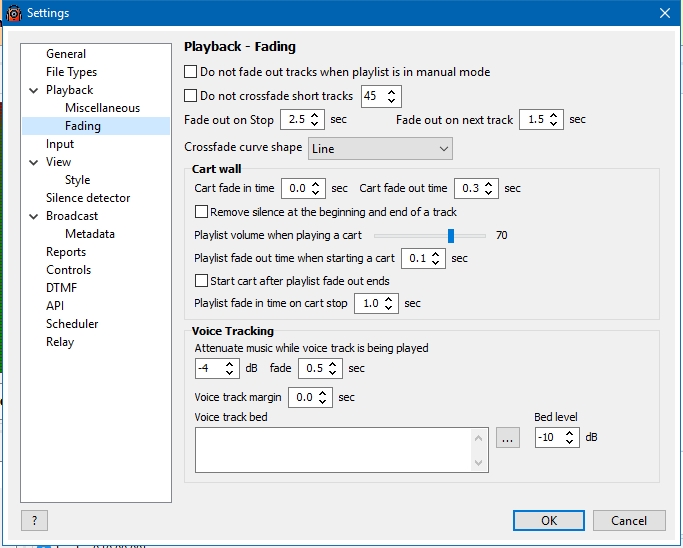

  • check crossfades if Trigger mix at is correct there (you seem to have enabled "Start fading out on mix" so red line that shows mixing and blue box for fade out start at the same time)

Normally, the mix and fadeout points are the same. When the track nears the end, it begins to fade on its own, triggering the mix point, and then RB fades it out the rest of the way, so that there is just enough overlap. I will say that in most cases, this works just fine. Yes, there are a very limited number of songs that may need individual attention, but, as I stated, most of the time it works just fine. (And I have also not worked on fixing of those yet, so there should be no inidividual mix/fade points set.)

Exhibits 05-09: File types and fading settings.
