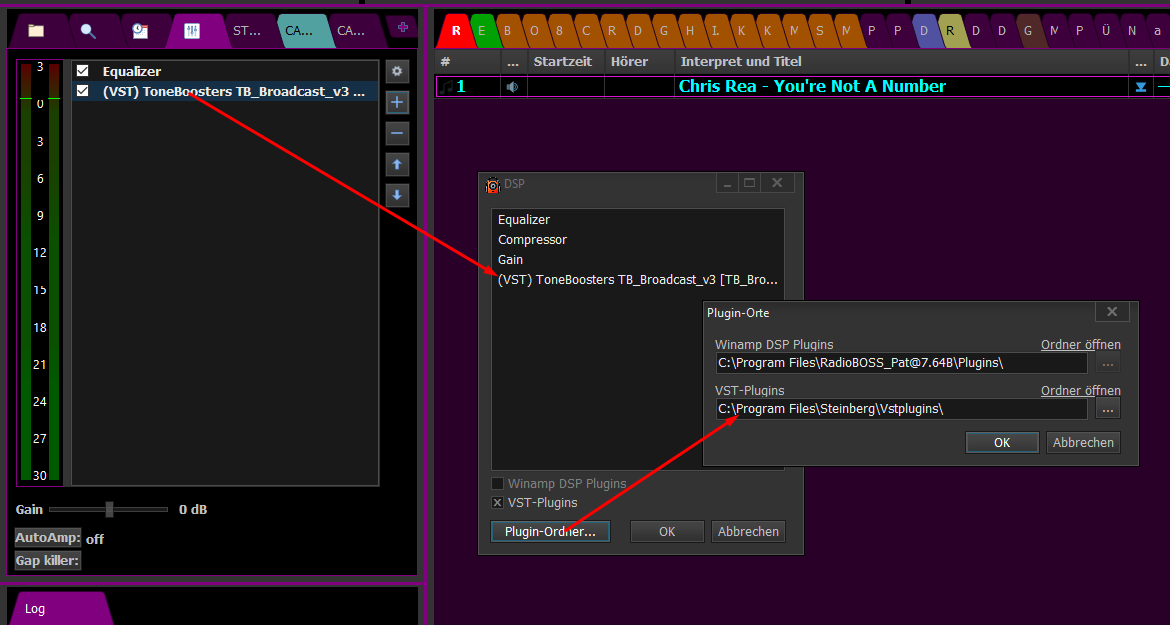

Up to this screen it appears but when I click on ok nothing happens, with others no problem
Do you mean you see the plugin in the window when you press the + button, but then you select it and press OK, it does not appear in the DSP list?Up to this screen it appears but when I click on ok nothing happens, with others no problem
no, non mi sono spiegato, anche io vedo la stessa schermata che hai postato in /program files/steinberg/vst poi clicco su ok e non succede niente sotto le etichette compressor e gain, tone booster tb brodcast non appare come invece appare a te
no, I didn't explain myself, I too see the same screen you posted in /program files/steinberg/vst then I click on ok and nothing happens under the compressor and gain labels, tone booster tb brodcast doesn't appear as it appears instead to youno, non mi sono spiegato, anche io vedo la stessa schermata che hai postato in /program files/steinberg/vst poi clicco su ok e non succede niente sotto le etichette compressor e gain, tone booster tb brodcast non appare come invece appare a te
JB Broadcast is a 32 bit plugin, and TB Broadcast, which is basically the same plugin upgraded by a different developer, is 64 bit. You can get the same sound from either plugin, just keep in mind there is no bridge for VST's; thus, the 64 bit version of radioboss needs TB Broadcast, and the 32 bit version will need JB Broadcast. Hope this helps.I tried for the umpteenth time to download Tb brodcast in the programs directory but when I insert it into radioboss it gives me nothing while the jb brodcast version, the one on a blue background, recognizes it and works. You can't see the tb version you posted with the brown background. The PC is 64 bit
Where can I download this?TB Broadcaster is ONLY for 64bit Radioboss
You can get broadcast and some other useful plugins from https://www.production-expert.com/production-expert-1/get-all-the-toneboosters-v3-plugins-for-freeWhere can I download this?
