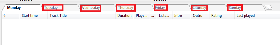

It would be great if RB could charge 24 hours.
It could even be per day:
It would be an amazing option for all those who need to prepare their weekly schedule.
Even for "live users", the option to block inactive days could be added.
so that only the "Programmer" can know what will happen in the next few days.
This could be an example of Monday:
programming with "active commercial blocks" to be updated at any time, before its broadcast.
RB is fantastic, I feel like it's possible to do it in the future.
