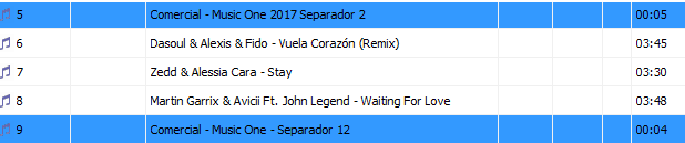

The track that continues, is not a file type
The selected function should only affect the mix of the track, at the end of this track that follows.
(Because the continuous track is also a file type)
The priority here should be the transition point of the file type.(In this case 0.5 seconds)
Or am I missing something?
Everything works fine, if after this track "That is not a file type" continues another normal track, but fails to have another type of file
Currently file type setting "Override previous track mix point" has higher priority and it won't be changed. This setting allows to run commercials and be sure that they are not overlapped with music or jingle.
Exactly, that is the idea I have of this function.
In other words modifies the point of mixing of normal tracks, when it follows a track of this "file type"
But in the image that attached this by changing the point of mixing, the same type of file.
This example may be more easy:
-Music
-Jingle (file type)
-Music
-Jingle (file type)
with the option "Override previous track mix point", is should modify the mixing point by default, only in the music (for example the second song should apply this time to the mix, since continuous file type). But never change the time of mixture of the Jingle.
The image can be seen as the mixing time of the jingle, that should be 0.5, is actually 1.5
-Music
-Jingle (file type)
-Music
-Jingle (file type)
So the "Jingle" here has the "Override previous track mix" set? I think you should create a separate topic about it and provide more details - it will be easier to discuss there.

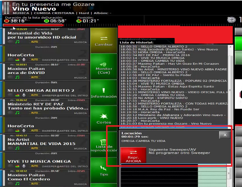

It would be good to show the player when a VoiceTrack play.
A speaker may speak about the intro and overlap with the voicetrack if you don't know that it exists.
Other software have a unique place in the interface for this, showing the time remaining for that start, and the opportunity to cancel it.
Would be very good to something like this

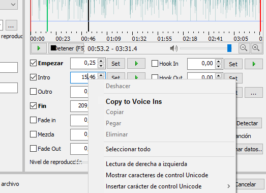

I attached an image with an idea to copy the point of the intro to the voicetrack point

I tried it two or three times and in one the entire program freezes completely. (The window was open)
If it happens again, please wait for the "freeze" message box to pop up and then send the bug report.
Are inserted automatically always this track is playing?
Yes.
What happens when using witch Teasers?
Teasers do not play voiceovers.
The duration in autohoot by default is disabled. (When you have the window and autohoot this enabled)
