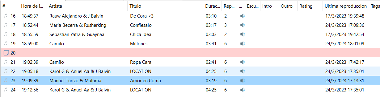

Hourmarkers not working on my air pc.
(It is not updated when modifying the playlist).
Interesting, can you please give some details on how this occurred? If you disable and then enable markers again, are they shown correctly?
When there are few commercials the white background is not appropriate in ads scheduler skin carbon
Thank you, will be fixed in the next update.

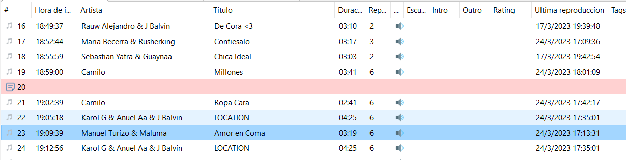

A quick test I see that it is when I lower the track that is being played. (When I raise it, it work correctly)
Turning off and on marks fixes it.

Fast forward the song doesn't update the hourmarker either. (In radio it is not very common, but it should be taken into account)
