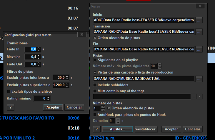

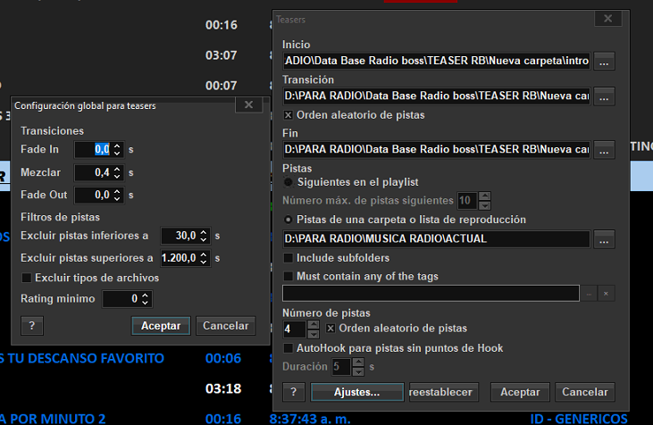

It just happened to me that I selected 3 themes and selected two effects in a row
Please send a screenshot of the Teaser configuration window.
