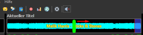

Hello, could you implement a visual improvement so that the song title is not overshadowed by the track status bar?
A possible solution would be to always highlight the title
Another would be to change the color.
I have tried several color combinations but it always looks opaque when passing the status bar
maybe instead of the white transparent bar a green-yellow bar showing the progress,
maybe even with adjustable color
Just a suggestion :-)
This is, actually, a feature :) The title is supposed to be displayed like this. Is it a big issue? We can add an option for this.
IIRC it uses some gray color shade with semi transparency.
Just a suggestion :)
It is not a big problem. But it will help to have a better visualization of the title.
Yes it would be great to add this option
