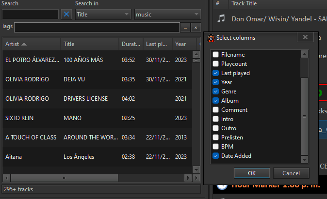

Is it possible to add the "tag" column in the search engine?

The search should ignore any accented characters, can you please give an example when it does not?
Ok, image 1 shows a song with accents. (without searching)
In image 2 the search Without accents did not show the song seen in image 1.
In image 3 the search did find said song but it ignored the song that is in image 2

I think that what RB did is correct, the complete character is ignored, so Á is different from A, if you write: lvarez, both results will appear.
the main idea is to write the complete word
but in my case I would prefer the search engine to be like in Windows. because I can write the title of a song in the search engine, for example the word: "ALGUN" the search does not show me the titles that have the accent on the "U" (the correct word is "ALGÚN". In this case it forces you to write with the accent, which is annoying for people who don't know how to place accents on the keyboard.
I understand the situation and I think that for all languages that use accents, this search does not work.
I think the easiest and fastest thing would be to remove all the accents. But obviously the professional solution would be for RB to search the DB without considering the accents, for Spanish: á = a, é = e, í = i. ó = o and ú = u -> Both uppercase and lowercase
Exactly, just like searching for something in Windows. It searches in the same way whether you write without accents and displays results with or without accents. In Spanish there are many operators who do not know how to use accents on the keyboard, when searching for a song they say they can't find it and end up downloading it again.
