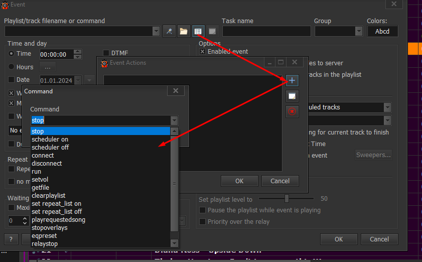

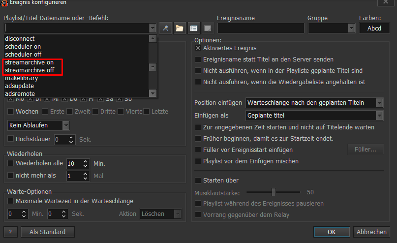

Can streamarchive be added as a command option in the scheduler pull down list please? We use it all the time...
It's already there.

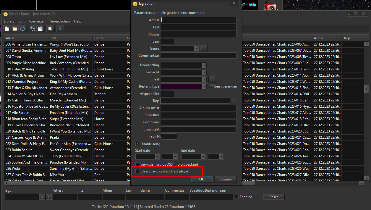

Hallo, when i play for exemple playlist 1. From a folder that i openend and just do random play. Then when i want to delete the "Last played" via "playlist" (speellijst in dutch) then "extra" and the "Reset played state" nothing is deleted from "Last played".
if you want to delete the played state in general, you have to do this in the database
To do this, mark the songs in the database, right-click and then click on track properties at the bottom, then switch on the item clear playcount and last played at the bottom.
Then OK and everythind is deleted
