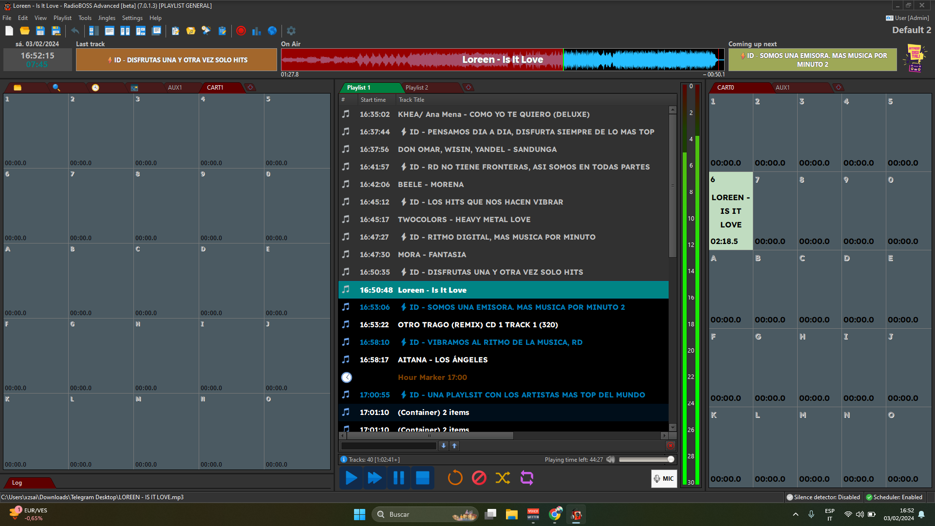

I don't know if this happens only to me, but the font change does not apply to the cart wall on the left side but to the cart wall on the right.
If you save the cartwall on the right side (right click on the tab / save) and load this saved cartwall on the left side, the font settings will also be applied

After closing and reopening the RadioBOSS, the font on the left side of the cartwall has reset itself and would have to be loaded again
It's not really how it should be
Looks like a bug, thank you.

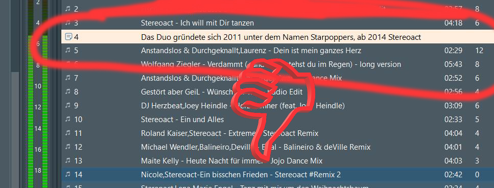

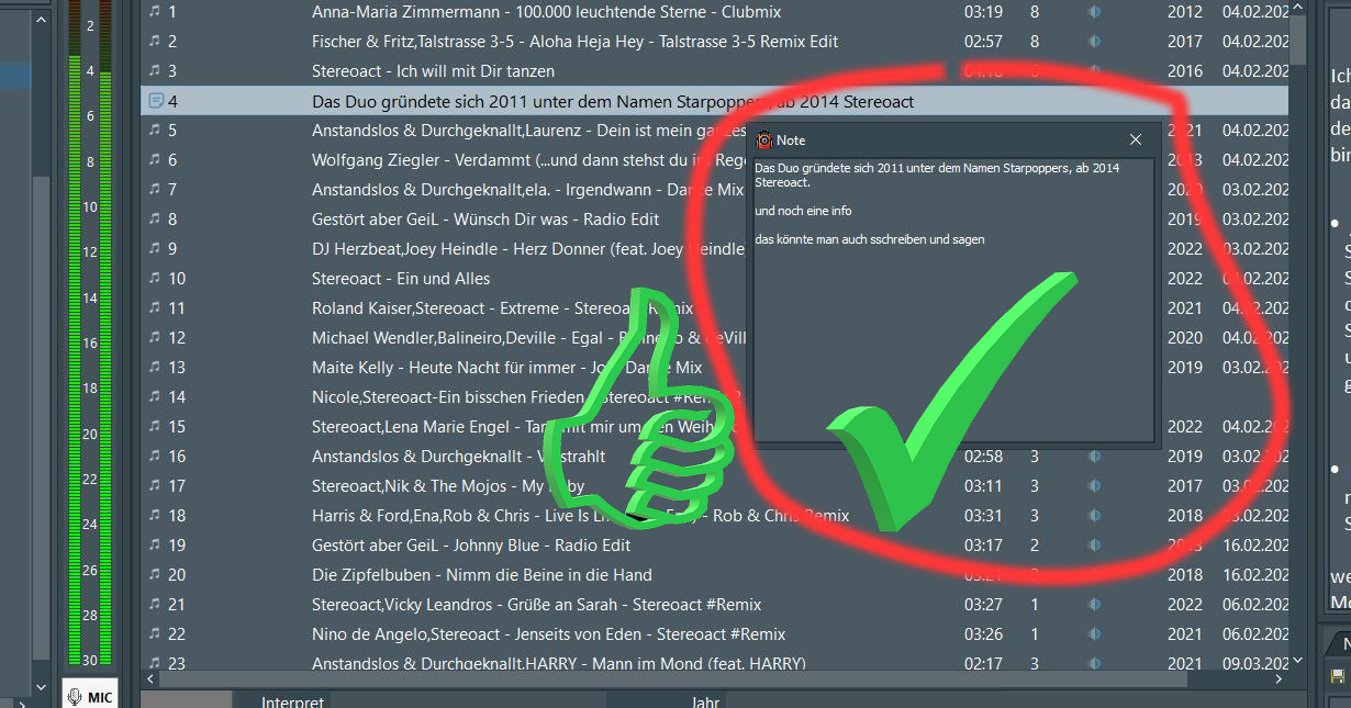

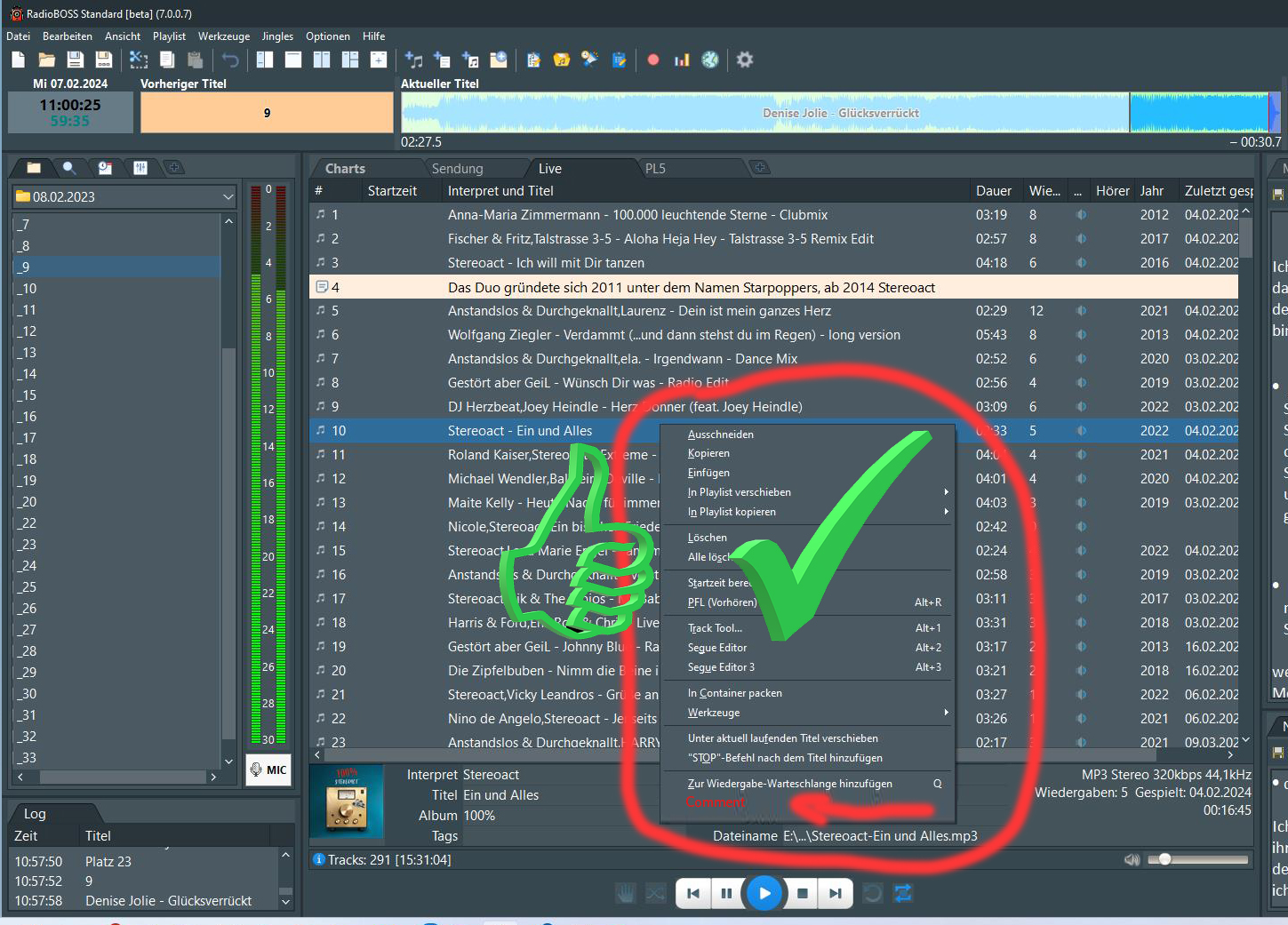

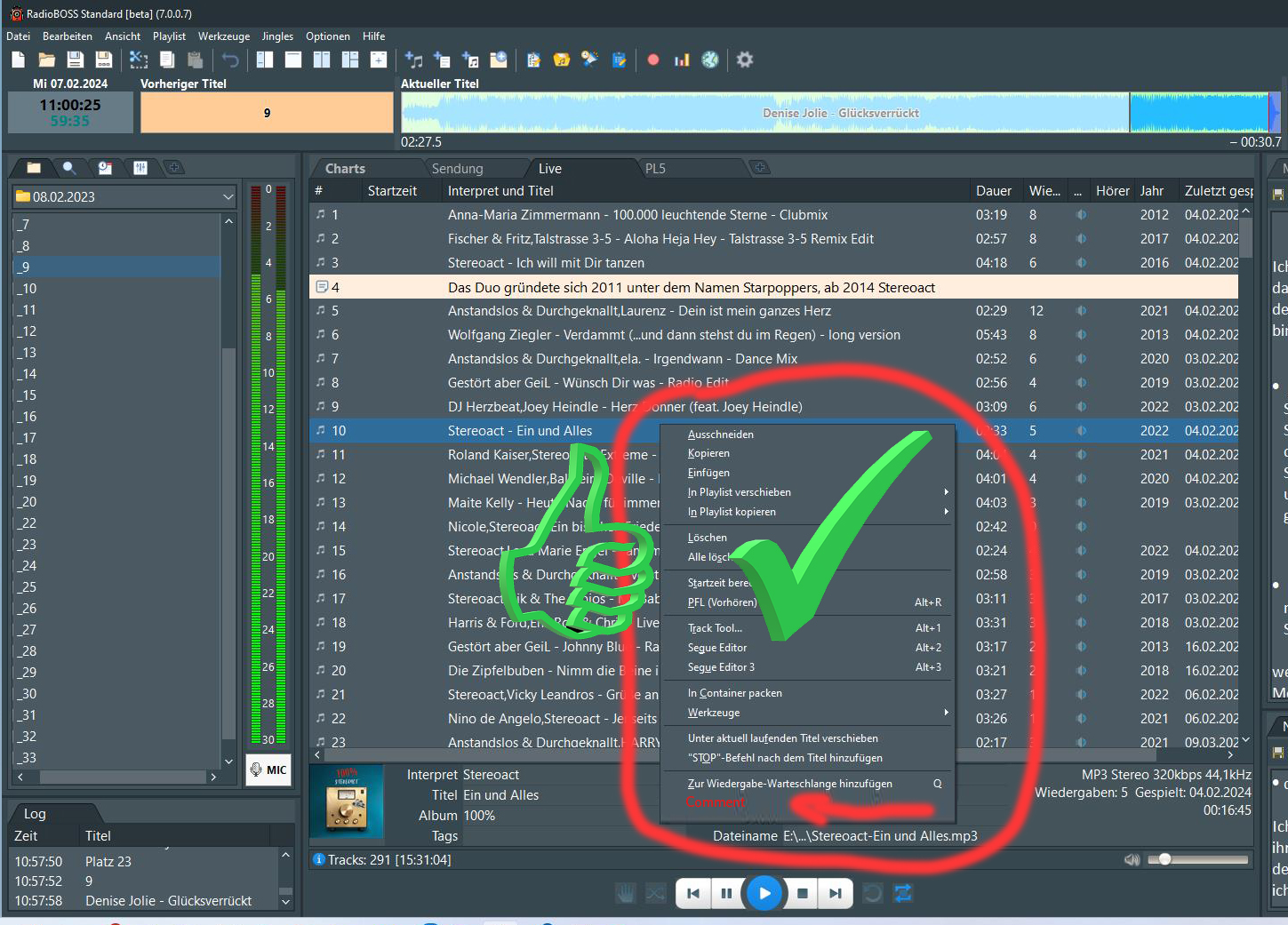

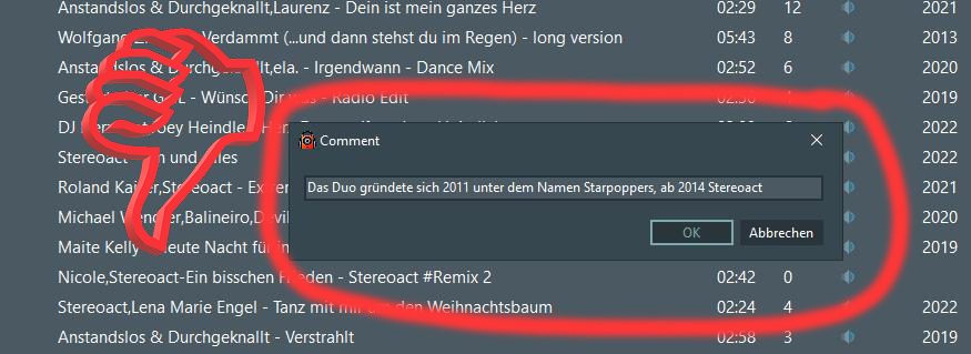

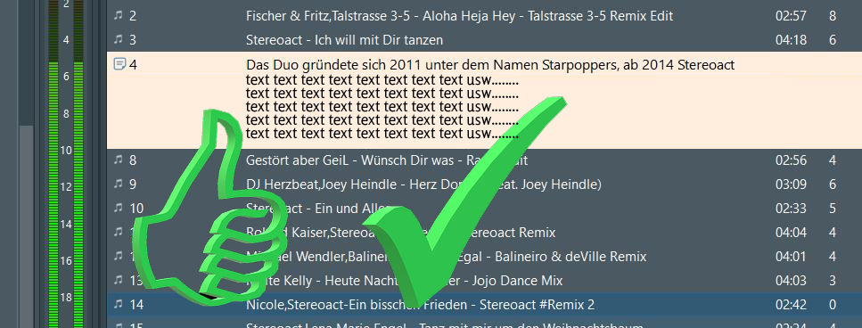

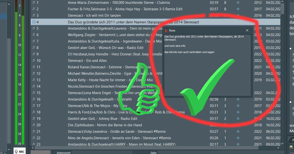

Is it possible to build an info field under each title at Radioboss? When you prepare a show you write the information between the titles that you want to say in the show.
- that you make the field larger at the bottom so that you can write more, currently everything is in a row
- Add the Comment menu item under the right mouse button
Thank you for the suggestions, this makes sense, we'll improve the comment item in the future.
Gute idee, übrigens schöne playlist :)
GOOD IDEA

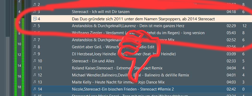

A bit strange. When a new playlist is launched, sometimes this empty line appears. These aren't new playlists, so I haven't done anything wrong in PLGenerator; all the playlists are from previous RB versions. This has never appeared in previous versions.
And it always appears at the end of the playlist. In the same playlist, sometimes it appears when launched, and sometimes it doesn't.
