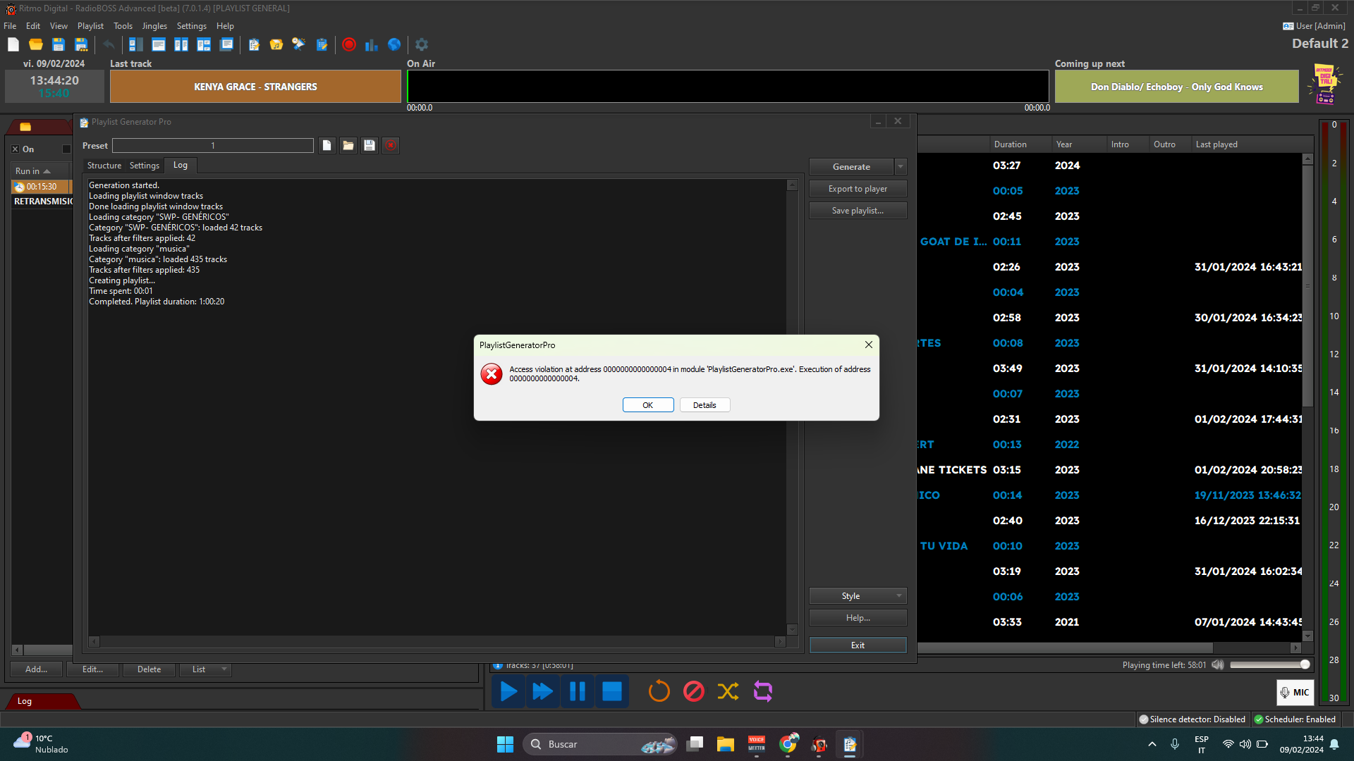

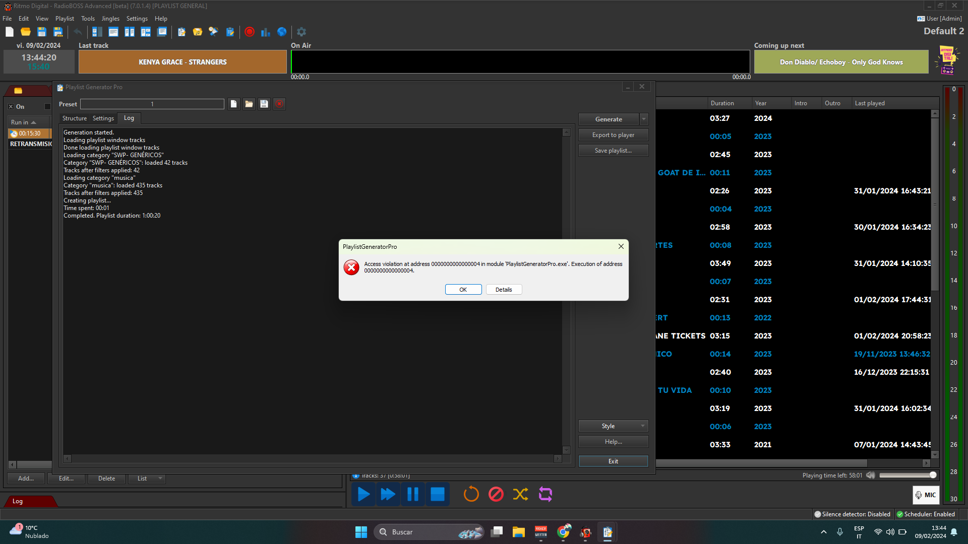

I also got an error message when clicking exit. This same error message appeared when I clicked "Generate" (RadioBOSS 7.0.1.4)
