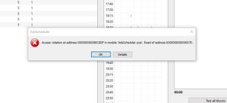

Another bug. When you change the style in Ads Scheduler to another one, and then switch back to Windows style, an error occurs.
This is a known issue, something was done in .1.4 and .1.5 updates about it, but the core issue seems to be in the styling engine.
