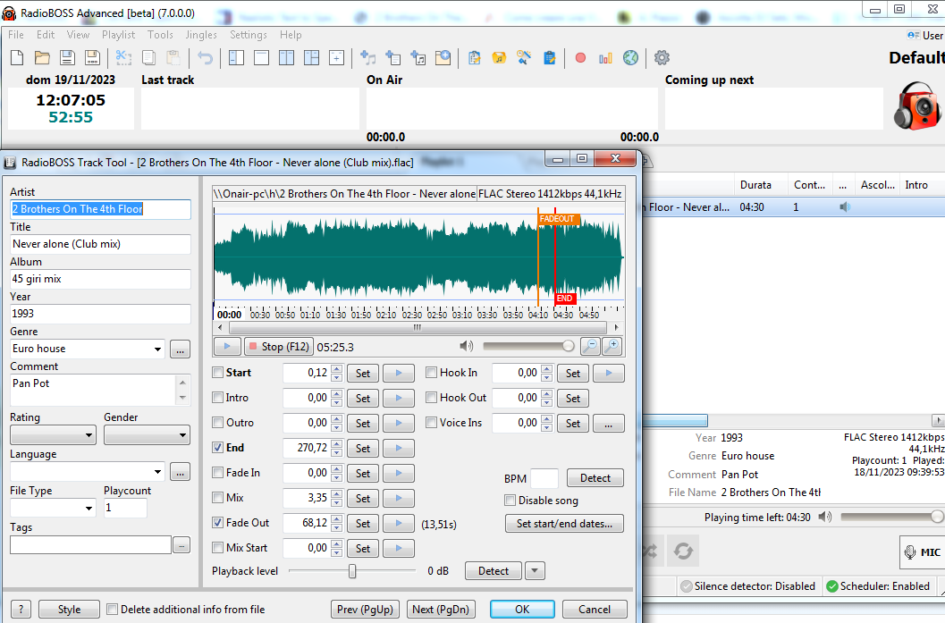

Can you please check if Segue Editor or Track Tool work properly - do they show the waveform? (they use the same drawing method as Nowplaying bar)
Yes, they work correctly.
