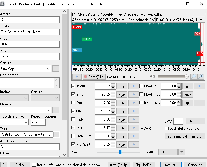

I don't have all my tracks processed yet, but in a test environment I'm seeing strange things.
With already processed songs, the track mixed 45 seconds before finishing (looking at the remaining time of the player), so the acceleration changed from +1.3 to +0.1
next track changed at -0.5
next track changed at +5.8
What is the reason for this?
Why did it mix 45 seconds before the end, do you have a mix point set there?
No, nothing has custom fades. The song that started the mix at that time was a processed one. (You can see the dots in the previous tracktool screenshot)
It's a test environment, in which I don't have any file types either.
I'm still looking closely to see if I can find what triggers this.
I found a track in the library that didn't process, but that wasn't the case with this playlist.

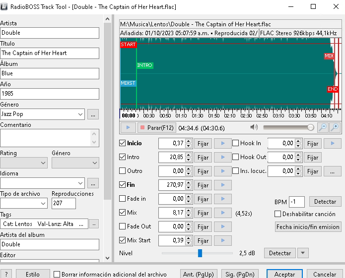

MixStart is also processed and from what I see now this can cause this
Yes, Mix Start will modify the preceding track's Mix point, which can result in what you experience (45 seconds mix point).
