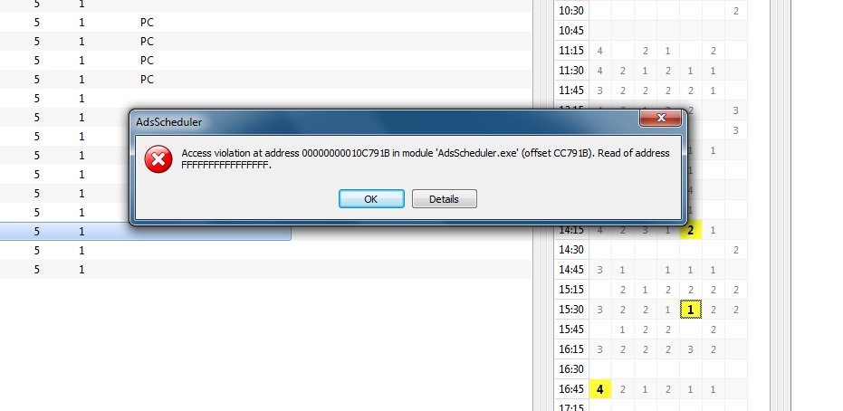

Error when click on the block in the ads scheduler."

I selected several expired ads to delete and then pressed "Delete".
This error started appearing and happened multiple times... I'm sending you an email with the bug report.
I’ve noticed that if I select more than one ad and try to delete them all, that’s when the error sometimes appears.
But even if the error doesn’t show up, it still doesn’t delete all the selected ads.
Thank you, this will be fixed in the next update.
