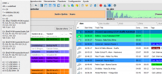

Aparentemente tengo el crossfader general (3,5 seg)..The next 4-second file is almost completely overlaid.
It is possible to add some field in getplayback that announces if it is really playing or if not, for streaming. (For example it is loading buffer or the URL does not work).
I suppose it can show states like "playing" or "connecting". There's no such state as "failed" as in this case it moves on to the next track in the playlist. Will it suffice?
Can you please start playing the teaser then press Ctrl+F4 and make a screenshot of this window along with the player window?
